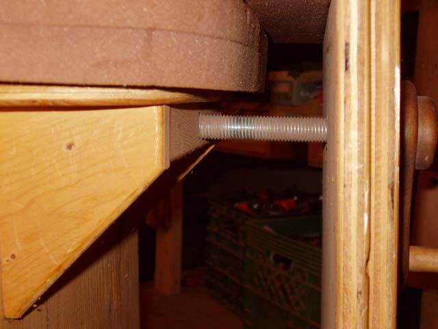

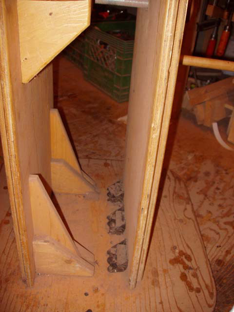

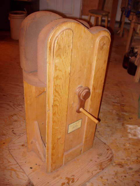

First, some pics of a 'well-used' example:
You can see the main details, I think...note the spring-type hinges (for slamming those screen doors) and the 'shelf' with the threaded rod (the coarser the better) below.
Basic construction is 3/4 plywood with doublers.
Approximate dimensions in inches:
Base is 24 inches square- this looks larger than in the photo originally posted in this thread. Perhaps with use a larger base was found to be an improvement? It is handy to stand on when you are working as it aids stability.
Height 36
Width 16
Distance between upright panels- approx 8 inches
'Shelf' approx 5" wide
Shelf approx 14 inches down from top ('lower bout' edge)
Foam is about 2" thick
Hope this helps! Hopefully somebody with more computer drafting skill will draw up some plans.
